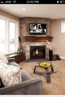

in my house there is a 'fake' fire place in the corner of my house. I think the people that owned it prior to me just wanted to put the TV on the wall in the corner and used the 'fire place' spot for one of those fake electric stoves. Similar to the photo.
My question is can I vent through the voided area in the back of the 'fire place. My concern is the heat build up within that area from the exhaust pipe.
