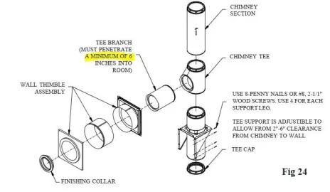

It sounds like you would be best with a Class A tee system, install it like you are passing through any other wall, you just won't have to worry about making such a huge hole. By doing this you won't have to worry about adapring over to class A.

outside the wall, with a piece of stainless chimney pipe that connects to the horizontal opening passing through the wall? Does the indoor double-walled black stove pipe simply screw into the stainless chimney segment that passes through the wall?
Yes, with an adapter. There will be a support on the outside. You will likely need to buy a thimble kit, you just won't need to be so careful with the combustible clearance.
Yes, the final assembly will look something like this.
