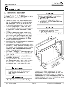

You should not need a cleanout t. The Accentra insert should slide into a cage. You attach your 4" exhaust to the cage and can access it VERY EASILY when the stove is slid out (it is on rails) for cleaning. When you slide the stove back it will form a secure seal with the gasket to the cage. Remember to insulate the pipe in the firebox area as per the manual. To me, the fact that the Harman inserts slide in and out on rails is one of the reasons they are the best! If your stove is used I would suggest finding a manual for it. If it is used and came without the cage I would see if I could buy one, Here's the page from my owners manual (P35i) that shows the cage. [Hearth.com] Venting insert into existing chimney
Thanks for the reply. I never thought about the fact it is in the cage, and you could just slips out for cleaning. I guess I will just need the 25' of SS Flex and a rain cap. Is it only necessary to insulate the portion of pipe from the stove until it goes through the damper opening?
yes, you only need to insulate to the damper opening.
