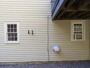

The deck and oil filler are possible challenges here - again the propane line will be removed. Is my best bet a horizontal vent without any rise? I don't think I'd be able to do a completely vertical section if I were to terminate above the deck. Would it be possible to come off the cleanout tee at 45 degrees to clear the deck then straighten it with a 45 elbow? It would look wonky but this is the back of the house so I'm not too concerned. I'm hoping to avoid a long horizontal run across the deck 😬
![Venting a Harman Accentra with several clearance challenges Venting a Harman Accentra with several clearance challenges](https://www.hearth.com/talk/data/attachments/299/299619-ec92dbf42440900f3cb5809b1a6a019a.jpg)
PL thimble placement will be determined by what style vent I use, so it'll either be near the floor (if I use a vertical vent) or close to where the propane thimble is now (since horizontal vent needs to be 18" off the ground). The stove specifies 3" pipe but does it make sense to go with 4" for better venting? The previous owner didn't use a tailpipe so I'll grab one of those + a new gasket. Duravent seems to be a popular product with several kits that may fit the bill. Selkirk has a very cheap option but the low price has me worried about quality.
