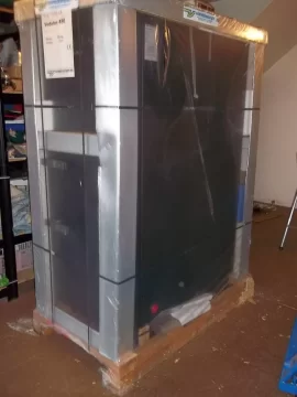

I bought the Lambda 450 this morning.Will be watching this one.![]()
CongratulationsI bought the Lambda 450 this morning.

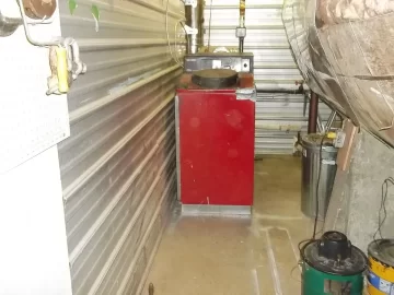

Good choice.I installed an older Vedolux 37 that I bought on kijji a ago.The Vedolux was never used and my Jetstream was 22 years old and on the second refactory.The Vedolux heats up much faster and puts out more btus.I am finding it easier to use.Congratulations

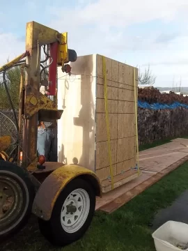

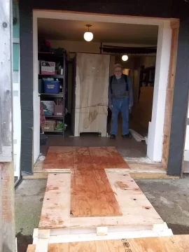

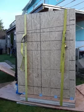

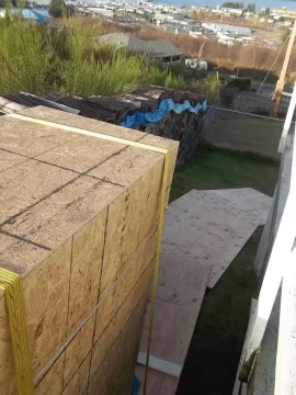

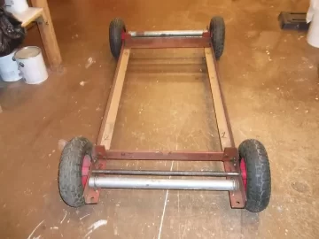

The bolts that make the feet for the boiler are they set in a inch or so from the outside fairing if they are I don't have to make any adjustments to my dolly . The dolly is 23 9/16" between the angle iron rails .I'm into my second winter with a Vedolux Lambda 350 and it's working perfectly. You can read about my boiler project at
https://www.hearth.com/talk/threads/my-first-winter-with-a-new-vedolux-350.180481/
Looking forward to following along...you (or the misses) always does a nice job of documenting your projects well with pictures...The bolts that make the feet for the boiler are they set in a inch or so from the outside fairing if they are I don't have to make any adjustments to my dolly . The dolly is 23 9/16" between the angle iron rails .

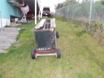

I have a bit of a hill to travel to get the Vedolux to the basement.
