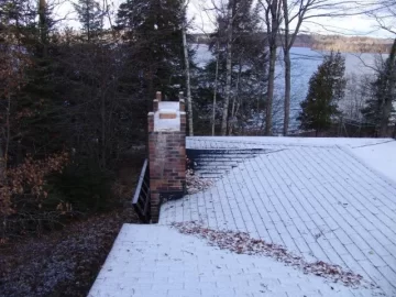

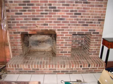

Please explain your current flue and venting setup.

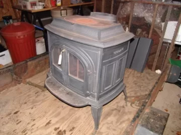

how old is the villigant you are looking at.
