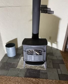

I just refinished a VC Intrepid 1 circa 1983. I am looking for information on UL certification. Anyone have any information on that?
