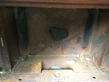

Sorry, I can think of a couple, but they are up in New England. Can you post some pictures of the stove in it's current state? When you say large castings are missing, how large? The top? Do you need a schematic parts diagram or manual?
I have downloaded a schematic but I understand one size does not fit all 1610’s and not all components shown apply to all stoves. The back of the stove is bare metal and the grate is missing. The side refractory pieces are in tact but I am not sure what else is missing.

It looks like the entire combustion package is missing. You can likely purchase the complete package, it will not be cheap! I personally, would stay away from the VC non catalytic stoves. Do a search on this forum “never burn”
Yes, the refractory shoe, fountain assembly and fireback are missing in that picture. That's about $1000 for starters, just to find out if there are other issues, like with the bypass assembly, thermostat, etc. Add resealing and regasketing too assuming there are no other issues like cracks developing, heavy rusting, warpage. And again, even new these could be tempermental, frustrating stoves to run.
It is sad. These were very good looking stoves that rode on VC's good name, but unfortunately they were a bad design.
