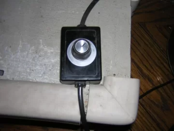

I know the guy who sells Quadrafire their fan speed controls. (I go woodcutting with him all the time) I'll ask him about the cost of a unit. Can you post a picture of what the unit looks like?
TMonter, thanks for the offer. I would be interested in what your friend says and may try to purchase one. I have a call into a dealer, but they need my serial number from the unit - which tells me that Quad may have made gone with a different control in the past few years (as my insert is just 4 years old). I have ordered the control that Brother Bart and granpajohn recommended.
Thanks for your help. Here's a pic.

I'll talk to him tonight and see what he says. I'm sure the speed control the others here recommended will do fine but it might be nice to have an option.
Can you take a picture of the back and the side so I can give him everything?
