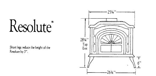

I'm going to go with a contrary answer to BG for this reason - the Resolute was sold with the option of short legs! In fact, the short legs were quite a bit shorter than the full length ones...my guess is that they were 3" or so shorter. Yes, notice the enclosed - the short legs reduced by 3 inches.
My advice is to cut them as little as possible - if 2" does the job, then cut 2 inches. Secondly, the hearth below must be looked at to make sure the reduced leg height does not mean too much heat radiated down. If the fireplace hearth and extension if very thick (say, over 8"), then you probably are A-OK. If not, you'll want to install a bottom heat shied on the unit or on the floor. This is basically a piece of 24 ga sheet metal suspended 1" underneath the stove. You can easily attach it by using little brackets which fit on the stove leg bolts, etc.
See heat shield in the enclosed line drawing of a Vigilant (underneath stove).

You're right, I got off on another thread and forgot to look up to see if a short leg kit was made for the Resolute.
