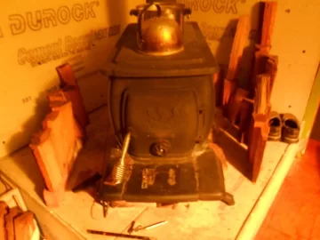

Go scrounging, my friend. Look for some dead stuff. Also, do this:
[Hearth.com] Using wet firewood
We ONLY do this while nearby for safety reasons ! ! If you are leaving or going outdoors, be certain
that the wood is far enough away to be warm but not hot. I do final dehydration, then load them in.
I know the patched ash drawer looks crappy but it's sealed. No runaways.
That whole underneath is packed with a sand and cement mixture.
Don't think I'd go that close. Further away but with a small fan slowly moving air over might be better.
Maple,
Disclaimer:
I / we NEVER leave it that way long. Our minimum safe distance is 18-20" in while
literally in the stoveroom, which is where we hang out. TV/familyroom/ gaming room, etc.
Otherwise it leans against the wall which also prevents any from touching during an accidental tipover.
Keepin' it safe,
CheapMark
