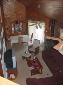

BTW, here's a couple of pics (w/ the woodstove still, but the pellet stove is in the same location)
Looking down from stairs to balcony, and the 2nd one is taken from where the wood stove is toward the hallway to my bedroom:

That first photo is a doozy dude. Was that taken with a fisheye lens? I have 3 ceiling fans in my humble abode and I plan to put a stove fan on my Englander...one that was made to screw into the back of the stove....
No, no fisheye lens...that's just the way it looks.
Actually, in the 2nd pic, you can see the stairway....I was standing at the top of that when I took the first shot.
