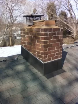

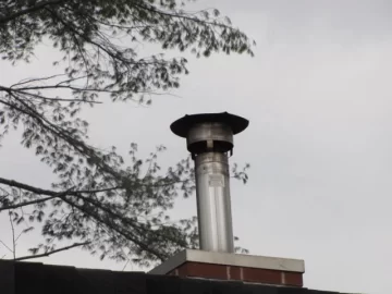

I've asked this same type of question in one of my previous posts, but the title was oriented towards Lopi Declaration owners. Anyhow, this insert requires 15 ft of liner. My chimney flue to the unit would be approximately 14 ft. What is the opinion of the crowd in terms of both being used (rigid & flex) as it will need to extend out of the chimney one foot?
