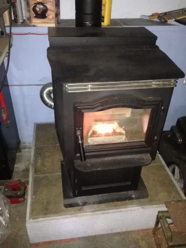

I picked up an old used and broken Harman P61 for my garage/workshop real cheap! Then I built a raised hearth and put in some nice Selkirk DT venting and bingo.
It just needed an ignitor, some paint, and a new control panel and a distribution blower! Then I added the the grill and a recessed ash pan door, a new smaller ash pan and a new black fire door!
I just picked up a nickel tile frame cheap and now I just need a nice scenic tile!
A nice little heater cheap!
