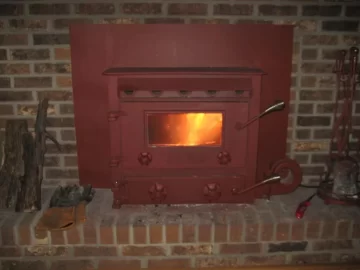

hey guys . well , the old baker fireside is doing great(seen below) , but am looking to become more 'green' . ok , that was a joke
the baker works great , its a big firebox , i can fit 20-22" logs in, but it was primarily designed for coal but i burn oak maple and hickory in my 2000 sq ft house because , well , i get the wood for free and anthracite costs money .it has shaker grates that the wood sits on , which are helpful in removing ashes from the ash door while burning , but im sure dont help in complete combustion.
if i bank the stove at night , then open the air up for about 25 minutes to crank it to about 500 on the door , and then choke it down almost completely , ill get 7 hour burns with enough coals (handful or two) in the morning to start up a few wrist sized pieces in the morning in about 5 minutes . while cooking around 350-450, shell burn about 1 piece per hour of normal sized wood. typical.
not a bad gig at all . but shes not all that efficient . its from the 80s im assuming . a friend has a soapstone non cat newer epa stove with the secondary air tubes and we can put 3 pieces in and those blue ladies wil dance ontop of the logs for what seems like 5 hours. . . completely controlled . less air knobs to fuss with , no glass tinting after 5 hours etc .
