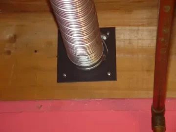

I ordered the 2" OAK kit and had it within a week for @ 48 bucks. I found a reducer at an auto parts store that was 2.5" down to 2" and used that. I did have to shave a little off the 2.5" side to get to fit inside the collar on the stove. I used a dremel but a bench grinder would have been faster and easier. The hose is a little to short to run exactly the way I want to but will fit at an angle from the rear of the stove up to about 4' above the floor on the opposite side of the brick for the chimney. As you look at the pic of my stove from my signature it is on the left side. What I want to do is run it straight down the side of the brick. This will help hide it from one angle because the brick actually sticks out further then the wall does. So, down the brick then across the back to the stove. I will have to pick up another 2" run of hose (need about 3') and a connector. I ran it last night and worked like a charm!
