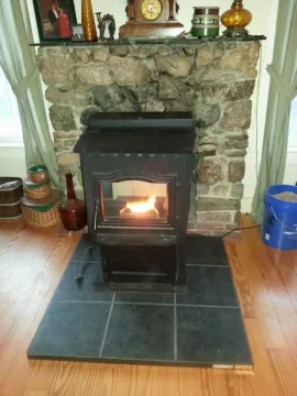

Got the 61 installed today. 3" out of the stove to a tee, then 4" liner 20' to a terra cotta cap.

I do. I installed this one at my in-laws today. They picked it up used. I cleaned it and replaced the flame guide, door and ash pan gaskets, and new combustion fan. Removed the motors and blew them out with the compressor.

Nice install,
Stove looks like it was made for that spot.
