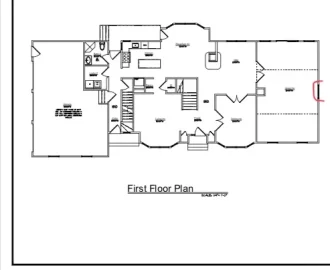

I posted awhile back asking about what stove would be best either a Soapstone Fireview or the Progress. After much thinking, and considering a new location for the fireplace, my wife and I are back at square one. We are unsure what is the best route to take. What would you guys recommend? Free standing wood stove? New fireplace with brick chimney on the outside of the house? Fire place with framed chase on outside of the house? Or something completely different. We are open to any other options! I would like something efficient. The room is about 450 sq feet. Total house size is about 3600 sq feet. Attached is a picture of the downstairs floor plan. I drew a red circle where we would want to put it. Obviously the window would be coming out.

The stove is an area heater. If the goal is just to heat that room then a fireplace or freestander will get the job done. If you choose a fireplace I would recommend a modern ZC EPA fireplace for much greater efficiency. This will have an insulated metal chimney that is typically chased (boxed in) for the best look. This option is much more expensive than a free-standing stove, but also a more desirable selling point if that is in the future. Figure $10-12K vs $5K for a freestanding install.
If the goal is to provide heat to the house, consider strongly putting the fireplace on the common wall with the rest of the house instead of on the far outside wall. This has several advantages. The chimney will stay warmer for better draft and cleaner flue. And the heat can be ducted into the main body of the house which would alleviate concerns about overheating the 450 sq ft room while maximizing heating gains.

Thanks begreen! Couple questions for you... ZC means zero clearance? What are some brands of EPA fireplaces would you recommend? I was looking at maybe the quadra-fire pioneer II? Most likely going to have to do it on the outside wall only to keep the flow of the room smooth and not all choppy. My goal is to keep the room big and open. If I build the chase on the outside of the house will drafting be a big issue? How tall should the chimney be in order to create a good draft?

Yes, ZC means zero-clearance. Sticking the fireplace on the outside wall is traditional in modern homes but not great for heating. If this is just for heating the room and not the house, then err on the side of smaller. The RSF Pearl line is a nice one. Pacific Energy makes the FP25 which has a contemporary look. If budget is tight there is the Flame Monaco.
..... If I build the chase on the outside of the house will drafting be a big issue? How tall should the chimney be in order to create a good draft?

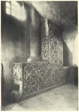

These are what I think of, when one says Russian Stove. This is one of a few installed in a large early-20th century home near me.
Those are still huge masses of masonry.
You need to learn how to use them to properly heat your space like any other woodburning appliance. When you don't need as much heat you don't heat up the mass as much.
That's an interesting one. That looks more like a rocket stove design, but certainly weighs a lot more than a Woodstock stove. Maybe more like a dozen woodstocks.
