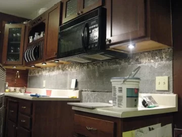

I did the same thing last spring but I did the backsplash in marble. I swapped out a double gang receptacle with a single outlet/switch, wired up a set of those GE halogen lights and screwed them to the bottom of the cabinets. They work great and I use them all the time.
Lights, new switch/outlet and wire ran me maybe $50.

Looks purty nice there mayhem. Now get that big bucket of mud off the counter! %-P

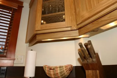

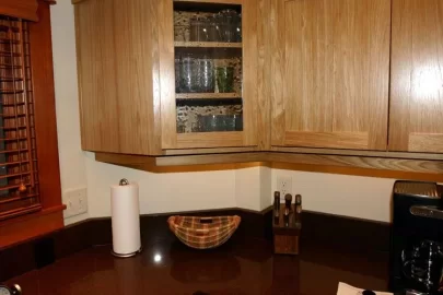

Our cabinets have little "skirts" installed to better hide the U/C lighting fixtures (Kichler halogens). Oh, wait...I'll take a picture. Rick

I highly recommend these from seagull lighting http://www.seagulllighting.com/Linear-Lighting.htm.
They aren't visable unless you are laying on the floor looking at the bottom of your cabinets, you can plop a light down anywhere you want, and they have different accessories. I have installed these in many customers homes including retrofitting my own. If you do go this route get the magnetic transformer not the electronic one, this way you can dim them. They are dimable from full on task lighting to low level ambiance lighting. Slightly more work in an old work setting like yours, but deffinately do able, you are going to have to fish in some wires no matter which route you go.
Kichler also makes the same kit as above but i believe they were they pricier one even though the parts are literally identical.
Personally i do not like the look of the hockey puck style lights, i think they provide more of a direct spot or cone of light on the counter top. The above ones spread the light evenly across the counter top.
