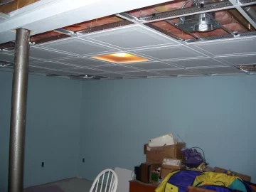

Ok, I am beginning to get the basement playroom done for the boys as they are getting louder, and louder and LOUDER, lol.

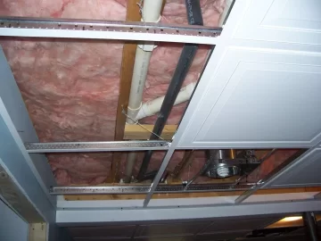

Anyway, I have several recessed cans like in the attached pic, and although I have CFL's in the majority of them, I was looking to put 2 incandecents in as I would like "instant" light vs the 2 minute wait for the cfl's to get up to brightness.
I've read that the incandecents get pretty hot and may not be a good choice with the ceiling tiles, and that I should go with LED's or CFL.s (The attached pik is a good example of each light fixure, the insulation is "above" the can, not around it)
Will be nice when this room is done.

That's going to depend a lot on the fixture you used. Some are rated for direct contact so you shouldn't have any heat issues, others you may have to be more careful with. I put up cans in our basement over the winter and have CFLs in all of them. They get bright enough fast enough that I didn't use any incandescent bulbs.

I can't imagine why you'd go incandescent for this application when there are some many good alternatives now. The CFLs we use seem to come on almost instantly at full brightness.* I've also been very impressed by the $10 LEDs we bought at Home Depot. They start fast, run cool, ,and put out great light quality.

Thanks for the replies guys. I'm going to pick up some new cfls and perhaps go with a better brand. (The ones I have are probably 3-5 years old, so perhaps they are on their way out)
Man, putting up this ceiling is like playing jenga...I had very little clearance right near the sewer line, so I had to put a panel in like 6 spaces down and float it across to the correct spot :)
