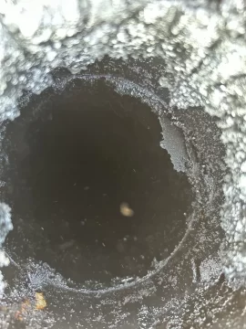

I’m not new to having a wood burning stove (grew up with 2 old Buck Stoves) but new to looking at it past, “house is cold, build a fire.” This is the first time cleaning my chimney myself. About 22’ tall Kozy Heat Z42 as the stove. There was lots of bubbly crust on the outside edge of the chimney that got me up there. After I cleared maybe 2 cups of that out I thought it was good as the chimney itself was open and clear, just a slick black layer. Will my one of the FB groups told me how bad it was and I was doing something wrong. I 100% understand the fire hazard but can’t find out where I’m going wrong with my burns. The wood is all dead, aged and covered (roof and tarp on the windward side). I don’t have a thermometer on it or measure wood moisture. I do try to get it going well, up to temp to kick on the blower, then neck it down a touch so it’s a solid fire but not heating us out if the room. I guess my question is does type 3 creosote happen to most chimneys and just clean it or try a good fire to get it hot? Is a creosote log worth a try?
