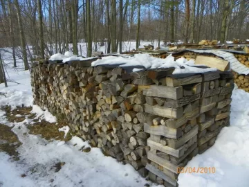

I've said it over and over again. I have no problem getting wood to dry stacking tight together. Most times the wood is split in spring, top covered usually be December 1 and then sit for 3 years. The center rows are just as dry as the outer rows.

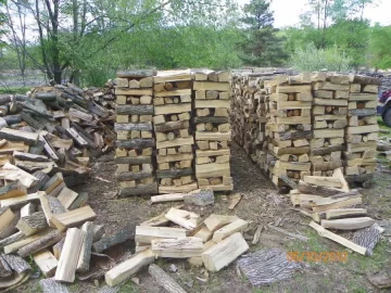

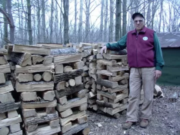

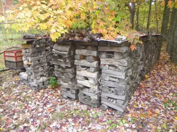

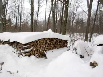

View attachment 121203 View attachment 121204 View attachment 121205 View attachment 121206 View attachment 121207
Sav I'm sure you're relating your experience accurately. On the other hand my MM or if you prefer something more practical the sizzle tells me some of the ash is wet.
So I'll take a stab at what's going on. 1) Looking at your location I would guess you are getting more wind and sun. 2) I did not stack in 3 tight but distinct rows like what I see you have. My mistake is that I really have one interwoven mass so less opportunity for air flow (see pic). 3) No top cover until the last 6 mo.
So to be safe I'm going to restack.

On the contrary, most of that wood was in the shade for most of the day in pictures 2, 3, and 4. Picture 5 was mostly shaded. First picture was about 1/2 sun.
Pictures 1 thru 4 did get good wind. Picture 5 is fair in that regard.
Whatever the case those are nice stacks you got there.-Joe

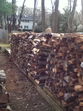

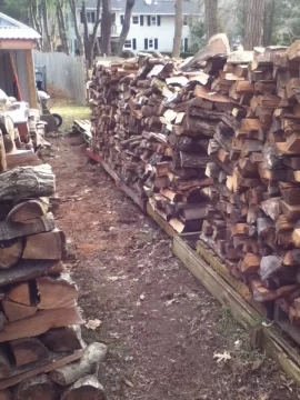

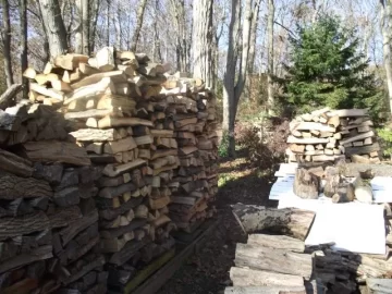

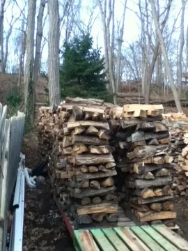

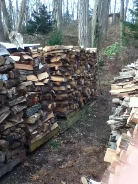

So I went ahead and restacked about 2.25 cord of mostly oak but also a goodly amount of ironwood. Not quite as good looking as some but it's tough w/ scrounge wood, usually bucked to all different sizes. Lots more air though so hopefully no sizzles a couple years from now.

Your stacks look fine. Importance is to get air circulation. Wind and sun are your friend. Wind being best.

I'm in better shape now. When I first started trying to get ahead I just didn't have what I needed. Just had a couple pallets so I stacked tight and high to get as much on them as I could. Now with more room to stack I can follow better practices.
Reactions: Backwoods Savage
Nice, very nice. Being a fortune teller, I can tell you there are very warm, toasty winter ahead for you!==c
