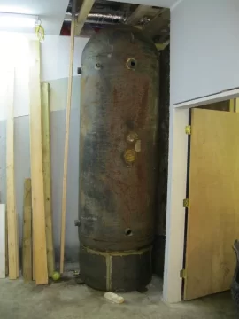

First one was a bear, and stressfull. It literally took a "hand" from the builder to get them to tilt upright. It was just over what the tractor tilt cylinders could do.

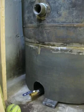

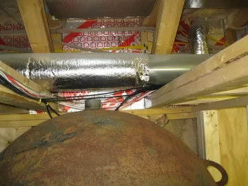

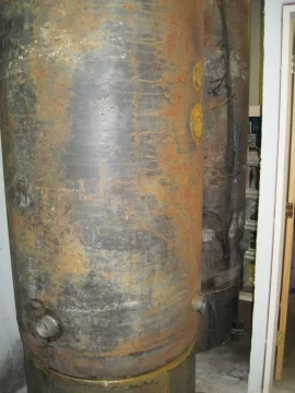

I was ready to load them back on the trailer and do stacked horizontal. I had the ceiling height (not more than a half inch to spare) so I didn't want to give up floor space. I think I'll be able to remove my poly 330gal biodiesel tank, and just run my twin 275s... So I think I'll use floor mount SX110V tanks for expansion.
I had to jack and use 1" of plate steel to get the tanks up enough for ball valve mounting. I just need to buy a shop vac adapter and smaller hose to suck out the rust and dirt from one tank especially. Lot of flushing in my future.
Been fun so far.
