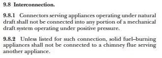

Ok I know this has been asked before but I have no luck with the "search feature" on this site and couldnt find it. We are in the process of buying a house in NH and they have two chimney flues. Two wood stoves in one- upstairs and basement. And the oil furnace in the other. I know it is a big no-no to mix fuel/exhaust types. But is it ok to vent two wood stoves into one flue? I would imagine at minimal it would require more cleaning, but does anyone know if this set up is legal/ok. The inspector said it is and id done all the time. Havent checked with the town yet.
