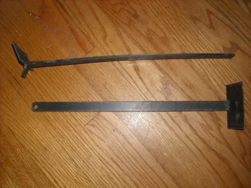

They are both breckwell tools. They both do the same thing(clean burnpot), But the one with the small tab over the scraper is for cleaning the heat exchanger tubes. The stoves it is for didn't have scraper rods installed. The other(no tab) is for the newer stoves. The hole in the handle is for pulling the scraper rod on the newer stoves.
