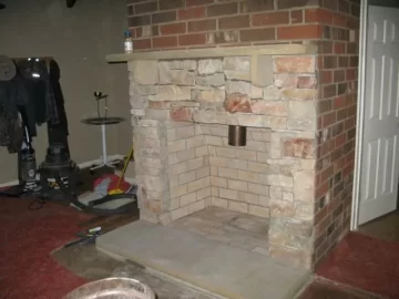

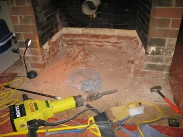

I had the same issue. Most all new stoves have a top vent and I was restricted to what would work for me. I decided to lower my fireplace floor and hearth. It was 12 inches above the floor and now it is 3.5 inches high. I can get a top vent stove now and install it inside the fireplace. Here are the pictures during and after the renovation.

That was my thought , if the hearth could be dropped, but the questions are unanswered. Crystal, can you post a picture of the current setup?
Yes, the hearth can be dropped. That is what I meant by removing some of the rock work. It is a very large area that would need to come out, about 2x bigger than what mtcates kindly posted. It is something that we do NOT want to do. Hence why I'm looking at stoves with rear vents that are under 22" (or a few inches over). It's much easier to find a lower flue stove and just chop the feet. There's the Resolute from the Vermont Casting line as well as a Quadra fire Yosemite that I am now looking at. I need stoves guys, not reconstruction of the hearth. I'm sure there has to be more, I'm just not familiar with the various brands and their lines. The local shops only want to sell what's in store. They are using the "don't tell them other models exist except what is on the floor" technique. Any suggestions on stoves are still appreciated.
mtcates situation was a bit more dramatic than I was thinking. The entire hearth doesn't need to be dropped. And it doesn't need to be dropped to floor level if one a few inches are needed.
