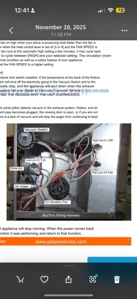

Sounds like your low temp. snap switch is bad. However,I do not know where it is mounted on your stove.On most, it is right beside the combustion blower, others are screwed to the back of the fire box. Yours should have 3 I believe, and, if it is marked it would be 120 degrees.
Reactions: Boxcar07 and johneh
Your low limit switch is on the exhaust after the combustion fan but before
the pipe exits the stove.
Remove clean reinstall and try your stove. If the stove does not stay fired
jump the switch and refire to check the switch
As Mt Bob said most likely dirty

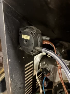

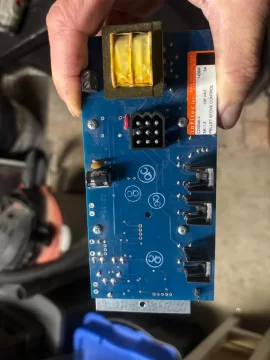

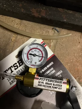

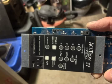

I am also running into an issue with this same unit and looking for professional advice. Replacing 120 snap disc didn’t resolve my shutting off after 15 minute startup with a nice flame
Here’s what I’ve done:
Replaced all sensors with OEM, bypassed and pressure checked vacuum pump(holds 5psi for more than 1/2 hour, that’s when I relieved pressure) cleaned intake and exhaust with a vacuum and used a compressor as well to blew out vacuum air line from valve back to stove incase of clogging.
I even disassembled panel and that’s clean with intact traces on board. Everything runs normally but doesn’t stay running after 15 minutes. Last year igniter was bad but I would hand start pellets and stoke the fire box and it ran fine as long as pellet fuel was in it.
