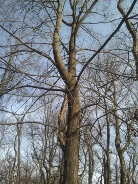

Hope it's Maple...only have a few in my area and was hoping to make maple syrup when the season comes around...no leaves left...many on the ground but could've been carried by wind...
Thanks, that's what I was hoping...there are a couple of Silver Maples near me and I read that you can make the syrup from their sap also although it doesn't yield as much...I read up on the process and plan to get my supplies including hydrometer, boil it outside till I want to test and get it to temperature on the stove...may be more pain than it's worth but it'll be fun anyway...thanks...Sure looks like a sugar maple to me

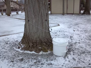

Sure looks like a sugar maple to me.....and I've been making syrup for many years now. Best way to tell is to look even for one or two leaves that are "hangin' on"......I think I see one or two on the tree and they look like sugar maple to me. You can also drill a small hole where you plan to put your spile. Don't do it until February when you plan on tapping. Taste the sap, it'll be sweet...
Just wondering how far up you put the spile in the tree
I searched the information and Scotty confirms what I found...I'll tap whatever trees I find, maybe 10 if I'm lucky just to try out the process...170-200 trees sounds like a lot but I guess you need that many to get a decent amount of syrup since it boils down so much...I saw all the equipment on Ebay...I like the one that joins the spiles to one tube...Only around two or three feet off the ground

Only around two or three feet off the ground. Get some plastic tube-type spiles off of the internet. You gotta wait.til late.winter/early spring to do it, though. Get in touch with me then, I'll be tapping around 170-200 trees this year if all goes to plan .....

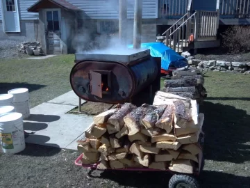

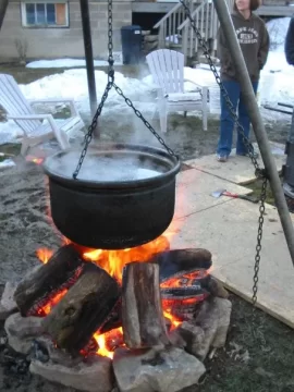

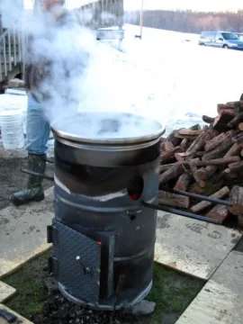

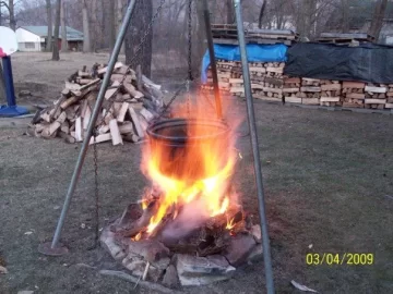

My first couple of years I used a mix of red maple, silver maple and sugar maple. worked out fine, but as I got access to more land and more sugar maples, I quit using the silvers and reds. Noticed a lot more yeild out of a gallon of sap when I went to all sugar maples. I'm getting roughly a gallon of syrup per 40 gallons of sap with all sugar maples. Some pics of my different cookers and tap set-ups
