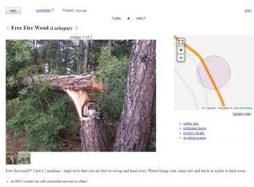

don't do it like this;
[Hearth.com] Tree felling technique
