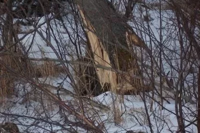

Thanks for the feedback. Hoping for a big wind may work but it would
have to come from a "not normal" direction to work since they brace each other for normal wind direction.
When spring gets here, swamp again.
Few more pics.

like asked earlier do you have access to any heavy equipment and rigging?
I'd attach a rope to tree #3 around about where the red 3 is (or even higher if you dare) and then notch it at the base and try to pull it to the left out from tree #1.
Hard to tell from the pic but it may already have some pressure in that direction.
