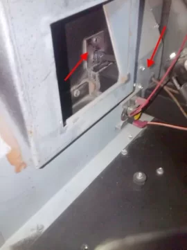

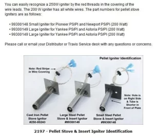

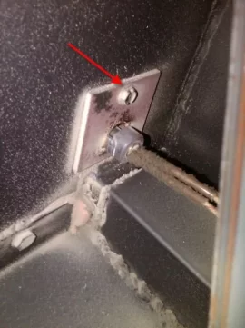

It seems to me that these are the steps according to the pics I have taken. See below:
1. Open or remove right side door.
2. Remove Back panel (1st pic)
3. Remove convection Blower to see access plate (1st Pic)
4. Remove screws in access plate (2nd pic)
5. In blower plenum remove Ignitor screw and remove ignitor. (3rd pic)
6. Unplug ignitor wires.
Plug in new wires and reverse above steps!

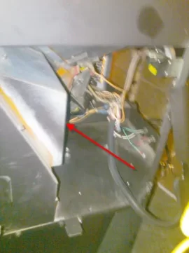

New ignitors after Sept 2009 are 200 watts. The old ignitors are 250 watts. See pic 4 below:
So is this correct? See pics below.
