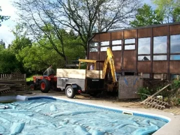

Well there's JD 420s and then there are JD 420s. ;-) To be fair IIRC it has four more HP than the later version.
What a pulling 420 may look like:
