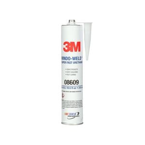

It is a strange place for water leakage but one other person on the internet had that problem and the water got in thru the top of the windshield. I noticed a groove where the windshield is sealed at the bottom of the grove. Therefore if this does not fix it, I will put some high temperature silicone I use for pellet stoves or Permatex glass weld from Autozone into that groove for a better window seal.

Pic 09 - High heat water proof clear silicone for top of windshield in grove after cleaning with alcohol.
Pic 10 - Permatex glass weld from Autozone
