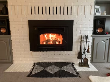

We’ve been running our Quadra Fire Expedition II all day every day since we had it installed at the end of November last year. It’s been doing a decent job heating our 3100sq ft home. Most days it keeps the first story between 71-75. There’s a couple of things about this stove that are giving me some buyers remorse. The main one being the burn times. I’m having to reload it roughly every 2-3 hours to get usable heat out of it. Longest burn I’ve gotten was just under 4 hours without having to use kindling to get a new load burning. Yesterday the temps here dipped just below freezing and I had to reload it 9 or 10 times. Overnight burns are not possible. I’ll finish this season with this season but am considering other options for next year.
My question is…
Would I have better luck burning 24/7 with a free standing stove instead of a flush insert? This would require some masonry work but I’m okay with that. I’d like to rely less on the blower anyway. The brick fireplace where the insert installed is the only option for a stove installation in our home. I’d probably need to look for a rear vented unit to get the stove to stick out of the firebox?
