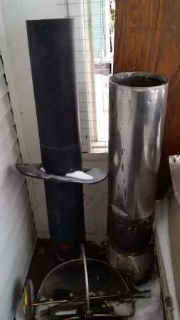

I have located a few stoves that look decent. However, the one that I like is, shall we say, less than decent. Also, I'm not sure if it is actually an insert, rather than a wood stove. I have attached a couple of photos.
... Yes, less than decent.
Anyway, I kind of like that it is junky. I think that after I clean up a bit of the rust, it would look good in the room. I did go and have a look at it, and it seems to only have surface rust. It is difficult to see in the pictures, but there is a crack that runs front-to-back in the stone at about the middle of the unit. I don't know when it was made. The seller says the only identifying mark on the back says "Manufactured by Martin free standing fireplaces".
So, if I were to buy this, could I actually use it or would it only be good for taking up space?
