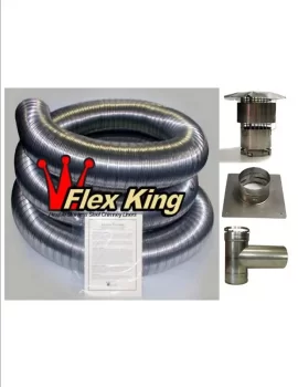

I need a liner to bring my set up to a better level. Currently it's connected directly into the block off plate below the fireplace flu damper. The smoke chamber of the fireplace creates a great draft reducing space where the smoke can just circulate before it goes out of the flue.
I just saw these liners on line and was wondering if anyone is familiar. They are supposed to be better quality than the 316 Ti.
Here's a quote from the web site:
"AL29-4C®, a superferritic stainless steel designed for extreme resistance to chloride ion pitting, crevice corrosion and stress corrosion cracking, as well as general corrosion in oxidizing and moderately reducing environments. AL29-4C® is an ideal choice for resisting deleterious effects of corrosive condensates created by partially or fully condensing natural gas and propane fired heating appliances.
Why use 316ti or 316l alloy when you can have AL29-4C the best stainless steel alloy
made for chimney liners on the market today for the same price or less!!!!!!
Flex King liners are manufactured in Pennsylvania USA. Because we are the manufacturer of Flex King Liners and Kits we eliminate the middle man and pass the savings on to you!
The Flex King Chimney Liner Kit is a 6"x15' Stainless Steel, AL29-4C Flexible Chimney Liner. This kit comes complete with a Stainless Steel Rain Cap, Top Plate and an a Two PartTee.
With a wall thickness of .006 the Flex King is the perfect solution for your deteriorating chimney or for installation with your new heating appliance. The Flex King has the quick connect component system which is installed by simply tightening the clamps. It comes complete with a Lifetime Warranty that is transferable to the new homeowner should you sell your home."

not an expert and still learning, but i think these may be for gas appliances....(?)

Hello delp, these stainless steel liners I mentioned are UL listed as chimney liners for wood burning applyances. These are usually common ones that can be used for wood burners: 316TI, 316L and the AL29-4C which is supposed to be the strongest of the three.
Here's another quote from the Ebay site where I found this liner.
Item specifics
Brand: FLEX KING AL29-4C
Power Source: ALL FUEL
Type: AL29-4C Stainless Steel
HVAC Product Type: FURNACES, STOVES, INSERT AND WATER HEATERS

Yep, we used flex king for our stove...getting another for the boiler flue.
We were happy with the kit.

I looked up the link you gave me and found out just what you found. The AL29-4C seems to be for gas and oil furnaces or appliances. The Ebay site I found lead me to believe that it would be OK to use this instead of the 316TI. It even states that it is the strongest stainless steel alloy on the market today! Although the link you gave me states that it is normally used with gas and oil furnaces, it doesn't say that it can't be used with a wood stove. The 316TI liner that is most commonly used for wood burning liners is the same price as the AL29-4C.
