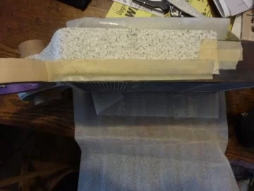

Hey, I just thought of something you can try. Don't put the gasket all the way to the bottom of the cat, then tape the bottom edge of the gasket so that it will more easily slide into the housing, without the edge of the gasket catching. If you start above the bottom, you'll have to cut off the extra on the top, as you can see in the attached pic.
If you click on this pic, you can see a half-width strip of interam gasket that I cut off of the roll for my SIL's Dutchwest..
