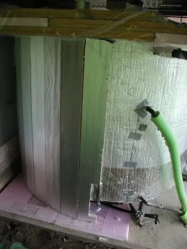

I did the slit polyiso thing myself. Buy damaged sheets at discount from your local yards - you can save 50% in some cases.
  • Time To make Decision on Insulation For Storage

I used 6" pink fiberglass to wrap my tanks and than boxed them in with 2" thick foam.
Go to my website at www.upnorthenergy.com and click on the photoalbum to see my system in detail.
NWM
Nofossil,
Is that foil coated bubble wrap on your tank? If so, is it right up against the steel? If it is in contact with the heat, how do you supposed it is holding up?
Fred61 said:
Nofossil,
My insulation (as best as I can remember it:
Stainless steel tank wall
1" foamed EPDM (came with tank)
Aluminum foil
Clear 'big bubble' bubble wrap
Reflectix aluminized double-side bubble wrap
1" Polyiso board
'Small-bubble' clear bubble wrap
1.5" polyiso board
misc fiberglass to fill in spaces: 3" - 12"
1" polyiso board
Plywood enclosure
I may have missed something....
