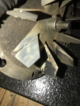

It takes a bit of scrubbing with the wire wheel on the drill driver but I think that black carbon adds some wind resistance when turning. Cleaning and spraying with some dry moly makes the petals smooth as silk and reduces that resistance quite a bit. Also clean any dust from motor.
Object of this cleaning:
- Increased surface smoothness
- Corrosion Protection
- Decrease adherence of ash and other contaminants
- Decrease drag and increase effenciency
- Prolong motor life
It is also possible to replace the impeller blade with a new one if it is too rusted, pitted or broken.![Smile :) :)](/talk/styles/default/xenforo/smileys/grin.gif)
