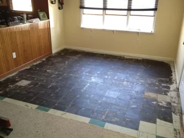

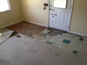

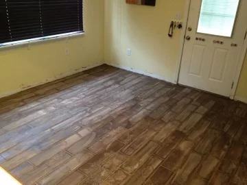

After moving in 3 years ago, it was time to replace the last of the remaining carpets, and vinyl flooring in the kitchen and foyer. This tile job will go from the dining room into the kitchen and then the foyer. We selected a 6" x 24" glazed porcelain tile from Lowes that has the appearance of hardwood. A relatively new tile, it was $2.78 a sq. ft. It is made by Interceramic and is part of their Forestland line collection. The color is cypress.
  • Time for a new floor (Part 1)

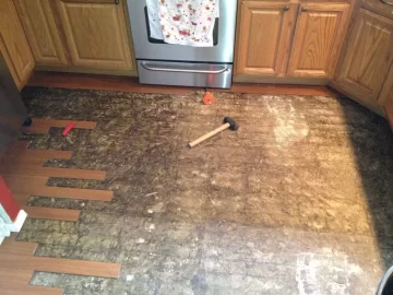

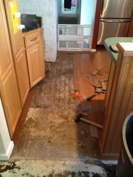

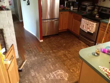

Into the kitchen.

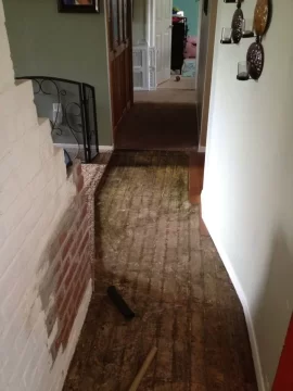

Into the hallway.

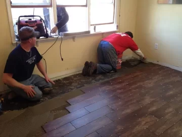

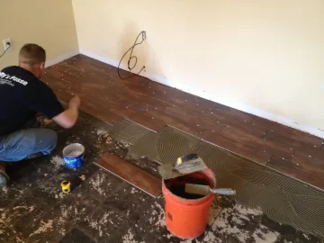

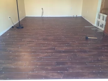

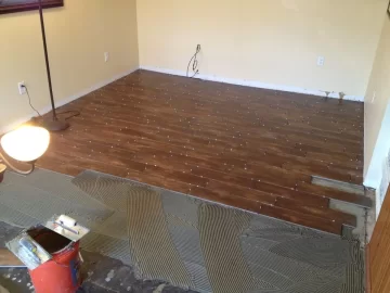

Laying some tile. Be easy on us as we don't do this for a living.
On this job, my pops did the cutting, I (Phillies shirt) applied the thin set and my older brother laid the tile.
