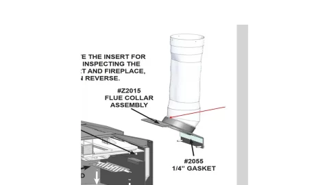

That's what drew me to the idea of a magnetic probe that i might be able to place on the insert neat the collar somewhere, but behind the decorative A25 fireplace surround. Wouldn't be as instantaneous or accurate as a flue gas monitor, but would give a fair reading of the top temps near the exit point near the collar.
Yes, that's a better plan. Does the flue collar have a neck that it could attach to? If not, the stove top, maybe switch to a probe that is compatible and attach that through the appliance adapter?
The A25 manual shows a flue collar neck that looks like it might be a good spot. If I can get my hand around there, i might be able to get a good attachment for the magnet at/near the collar assembly. And would avoid moving the insert or altering any of the installation or piercing anything.

What did you mean by: "attach that through the appliance adapter"?
[Hearth.com] Thoughts on this Flue Temp Sensor
The appliance adapter is what connects the liner to the flue collar.
[Hearth.com] Thoughts on this Flue Temp Sensor [Hearth.com] Thoughts on this Flue Temp Sensor
It could have a thermocouple washer held captive by the band clamp or an 1/8" hole drilled into the adapter for a 4" probe.
