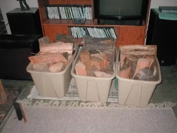

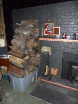

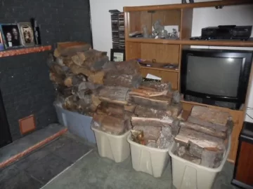

Buy a few large plastic storage totes at Walmart, and stuff them with the new wood inside the stove room. They will dry out nicely.

  • [Hearth.com] Thoughts on Mixing Seasoned & Unseasoned Wood?
I bet the heat dried the wood out!
