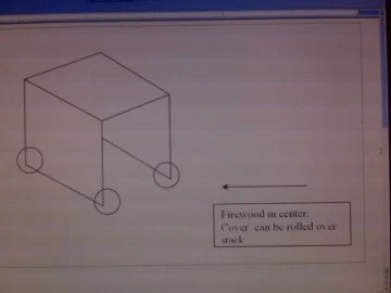

Here's an off the wall idea...
Sorry for the crude art!

I thought about the portable shelters, but the roof is too tall for aesthetics where it is in the yard. Plus the airborne aspect is a consideration. Werm - your drawing was what I was thinking....just not sure what materials and if it will be worth the time and effort. I do like the idea of it on skids - though not good for my applcation, that would sure speed up the hauling to the house!

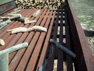

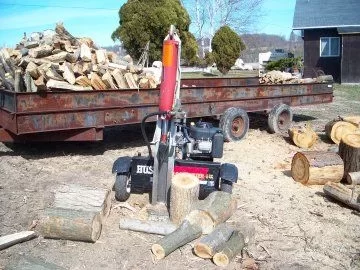

Use something like this and put hoops on it if you want it portable. I've got between 4 and 5 cords on this. I just take it out back in the sun and when I need it I pull it up to my shed and unload it. It's made out of a mobil home frame and is 25ft long. It has slats welded in for the floor so it gets air flow. You could make it any size. I have a smaller one that holds about 1to 1 1/2cords also
leaddog

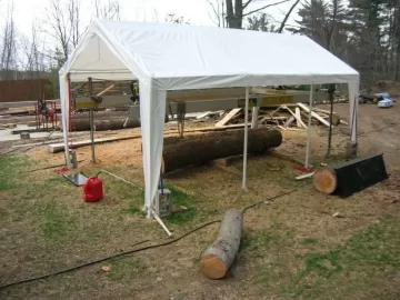

FWIW: A few years ago, I bought a $199 shelter from Walmart (I didn't use the side or end covers) for my sawmill. It came with snowload cable braces which worked pretty good although you could play a middle C on those cables when there was a foot of snow on it. Lasted for 3 years before UV finally weakened the cover to the point holes started to appear. Left open, it didn't move much in the wind (I doubled up the cinder blocks in the corners). I still have the frame and intend to use it again with either metal or fiberglass roof panels.
