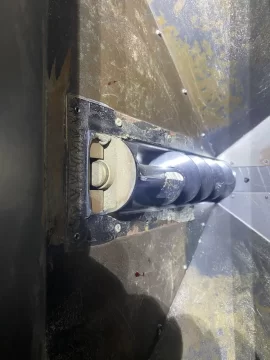

Obvious to me that the loaded auger was trying to feed extremely wet fuel. The owner deserves to pay for a service call, he (or she) is an idiot.

Me neither. It was on a Envirofire Meridian insert. I had only serviced one of these stoves before. Luckily it had a removable auger cover in the hopper. I dont think the auger would pull out the end as tight as it was. I ended up having to chisel that stuff out with a screwdriver thru the 4" hopper opening. Ended up running my thumb nail into the sheet metal edge and ripping the nail back in the process. Had to electrical tape up the thumb to keep from bleeding all overYou don’t need wet pellets to have this issue. Very powdery pellets will do this over time. As they go up the pressure of the pellets push the powder against the auger and the lignin binds it to the metal and the heat hardens it. I can say I’ve never seen one that packed.
