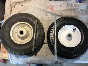

Pic 1 - Old wheel and axle left and new standard 5/8" wheel &!axle on right

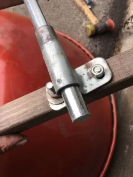

Pic 2 - new shaft goes beyond stop

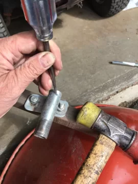

Pic 3 - Hammer stop so it sticks inside more and prevents new shaft from falling out.

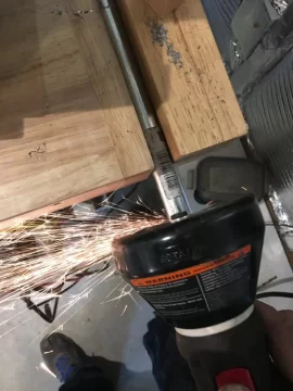

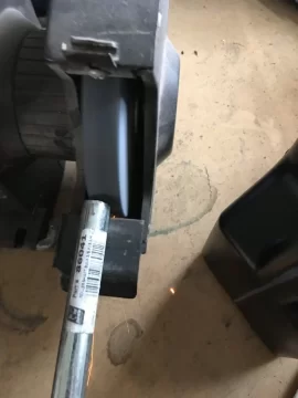

Pic 4 - cutting new steel rod down to axle size
Pic 5 - Grinding down cut end smooth

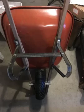

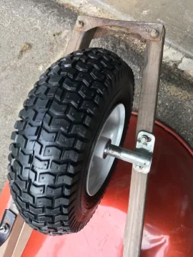

Pic 6 - New wheel fits and works fine!

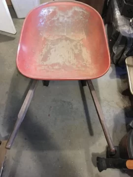

Pic 7 - 8 Old red wheel barrel works like new!
