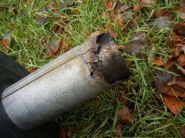

Harman p series manual states they can burn up to 50 percent corn. If you don't have multifuel venting its going to be hard on it. Even with multifuel venting the exterior of the pipe at the termination will catch hell. I can dig out some examples and photo if anyone is interested.
Thank bioburner. If you are bored, I like pictures. :)
Two years. Condensate on the outside is ugly. [Hearth.com] Thinking of adding Corn to pellets

Is that picture of a multifuel vent or is it regular vent? I would think the dealer just gave me regular vent. I would have to factor the pipe into the overall cost savings.
Multifuel. Been burning corn etc. since 2002. The end with the termination catches the brunt of the damage because of the temperature causing condensate to form. The rest of the pipes seem good for five years or so.
How does that compare to just burning pellets? I never really thought about the venting being a "consumable" part. class A chimneys last for years in a wood stove.
Wood stove temps are a lot higher and vertical. Might be that simson is just cheap.
