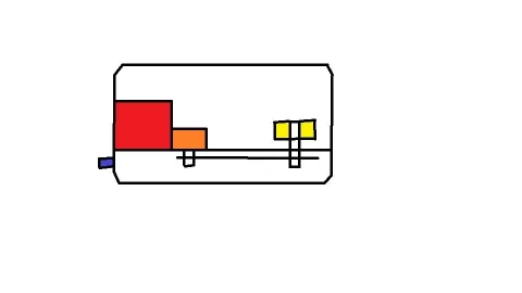

I'll try to draw a diagram this evening so you can get a better idea of the setup.
I found a video that's similar to what I have..... http://www.youtube.com/watch?v=ybVz0SYWJPc
Pretty cool. The capstan is nice too because you have infinite speed control. No mechanical speed control or clutch to deal with.
OK, here is a very rough drawing....
The frame is made from 1x1 square tube. It's about 36" by 20" by 18" high. If you take a look at the drawing, the engine is shown in red, the attached gearbox is in orange, the shackles in blue, and the capstan in yellow. The engine/gearbox is mounted to a piece of plate welded to the frame. Same idea for the capstan mount. There is a bearing bolted to the capstan mount to hold the capstan shaft in place. Underneath are the two sprockets - one on the output shaft of the gearbox, and the other on the capstan shaft.
For interest's sake, I think that the capstan shaft is 1.25" round stock.
If you were building one yourself, I'd recommend some type of guard around the chain area, just so that fingers don't get into the wrong places.
As usual, use at your own risk - no liability expressed or implied!! :-)
