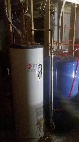

Well after spending the day hooking up my sidearm it doesn't seem to work. I've read a bit about it and it sounds like the thermosyphon is a tricky thing to get going. I've got the DHW coming out on the hotwater tank drain and then in on the cold water side. So far I've had it up and running for about 4 hours and I've only gained about 3 degrees on the hotwater tank. The boiler side has a circulator and is working fine.
Attached is a picture. If anyone sees a problem or has any advice or tips on getting the thermosyphon please let me know.
