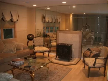

I agree..I have an enviro empress and spoke to enviro tech support yesterday asking the same question.
His advise was the same ..Use the HI/Lo setting and it will preserve your ignitor
Ran my stove for the first time overnight, looks like a warm and toasty winter for us.
