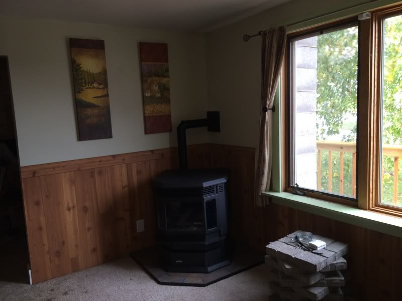

Is there any reason to get a better thermostat than the one that came with my quadrafire classic bay? Also, is it ok somewhere on the wall in the pic? Or should I run the wire to the other side of the room to get it farther from the stove?

First off, welcome to the forum and very nice set up. The thermostat that came with the stove is ok if you only wanna control on/off temps. If you wanna set different temps for different times of the day you would need a programmable one. Also, I would put the thermostat about 5 ft. above the floor and not directly in front of the stove. Probably on the wall to the left or right of the stove behind it would be good.

The t stat should be on an interior wall if available. Somewhere representative of the whole area you're heating, ie not in a warm or cold spot of the room.
The stat should be at least 15' away, and NOT directly in line or next to the stove. Any closer or in line with the heat output of the stove, and the stove won't heat the whole area.....the stat will shut it off too soon.

Thanks. I ordered the lux from amazon, should have it tomorrow. Thanks prime shipping:). Didn't go wireless, I will have to see how I can run the wire best. Might just hide it under the window sill and move it across the room. It would be on an outside wall, but it's a pretty well protected wall and it's well insulated,
.....and move it across the room. It would be on an outside wall, but it's a pretty well protected wall and it's well insulated,
Not usually a good idea....if you can get it on an interior wall, better choice.....even if it's a pain to run the wire. Is that carpeting on the floor? Pull up the edge and run the wire under it along the wall.
I can run the wire down through the basement, but I hate to have it run up a wall 5ft to the thermostat. I'll have to look in the basement again and see if I can find an area in the wall I could fish the wire through.
Running a wire is going to be really tough, basement is old beams like found in an old barn, walls are lathe board. Any recommendations on an affordable wireless thermostat so I don't have to mess with wiring?
The room my stove is in is 20' X 24'. The stove is in the middle of the 20' outside wall. The thermostat is on the wall, to the side, opposite the stove 20 feet away. When I built the room, I pre wired it for cable, home theater, and the thermostat. I've fished wires many times before and learned by experience. If you are putting the thermostat on an inside wall, at least you won't have to fight the insulation! A wireless thermostat will solve all that!
